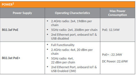

- *something to note is that all of the WAPs have a warning saying "Not enough electricity power is provided to this AP, its capabilities are degraded". But this has always been the case even from the start when we didn't have this problem with dropping connections. The Cisco switches that they are connected to are PoE and in one case we even added a separate PoE injector, but the warning is still there. Could this be part of the problem?

Your switches are only providing POE, not POE+. Have you enabled 802.11r and 802.11k? Try it on a test SSID and roll it to production if the problem goes away. Also disable the mesh, it’s just another thing to go wrong.

1) Lets try first with providing the APs with power mode POE + "at" to get it into full functionality for better performance.

PoE+ may be tough for us to implement at the moment since the APs are all mounted on the drop ceiling but we don't have the ability to run the 48V power cables over to them for now, if that is what is needed.
