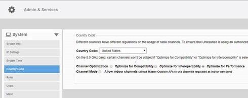

But please look under your Master AP settings, I think you have this feature.
Toggle your settings from "Optimize for..." and try Compatibility or Performance,
seems to be the best way to find your client optimal throughput settings.
Under System -> Country Code -> Channel Optimization.

This is great but you have it backwards.  The issue is that I had it set for performance initially, and it WASN'T performing.  When i switched to compatibility, that is when i got a huge boost in performance.  My message above is pretty clear, so not sure how that was missed.  But once again my experience with Ruckus tech support is pretty negative.
