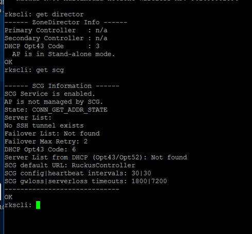

Here are the results I getting after I SSH into the AP. There is no controller IP specified. The AP is running in Stand-alone mode.
So, I'm not sure why I'm getting the slow flashing green light on the DIR led.
