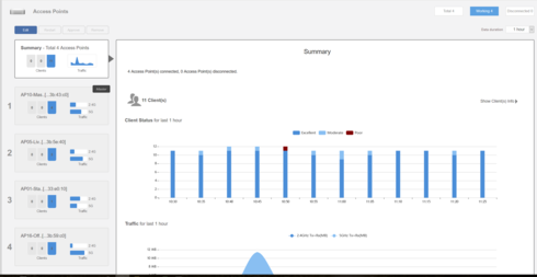

I have a working group of four R710.
Image_ images_messages_5f91c3f1135b77e2478f3f39_cf98c56b2d3da341973caf0481631984_RackMultipart20181018681301r0k-70b1ccb6-addd-48af-b03d-63ce7d56a101-270817841.png1539872891

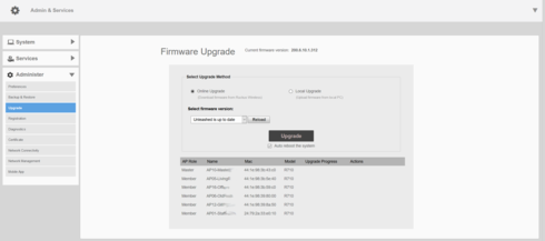

But attempts to add new access points to the group are unsuccessful. New devices are updated to the latest firmware version, but are only visible in the section Admin & Service -> Administer -> Upgrade.

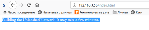

I can connect to new AP only via SSH, since via HTTP (S) I only see one page.
Image_ images_messages_5f91c3f1135b77e2478f3f39_81d10ca9c6e5915942c413ca84e58cff_RackMultipart20181018116937nh9-0461dd6a-b47d-484a-a3bc-a12577059475-1749252419.png1539873874
