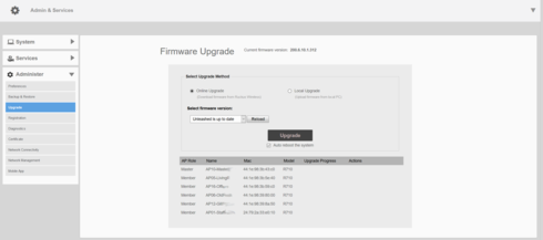

But attempts to add new access points to the group are unsuccessful. New devices are updated to the latest firmware version, but are only visible in the section Admin & Service -> Administer -> Upgrade.

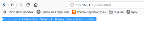

I can connect to new AP only via SSH, since via HTTP (S) I only see one page.
