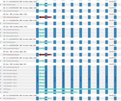

hope someone could help me. We serve a large WLAN of a hotel and getting problems with clients when they roam. the problem is so annoying while we are phoning with WiFi Calling and everytime you move in the hotel the Phonecall is cancled. i tested alot already but nothing helped so far:
1. Updated the System to version 5
2. turned 5 Ghz off to see if it just happend when switching between 2,4 GHz and 5 GHz
3. tested BSS min rate
4. removed some channels of that 2.4GHz Radio
5. Turned off and on fast roaming
6. Troubleshoot with internal tool of Ruckus
Image_ images_messages_5f91c3f2135b77e2478f52ba_295613ec8ef93707af46be82b52a2047_RackMultipart20181026261721ctf-a1a554c0-b8c5-4d49-9a49-869b0e587dd5-1797950902.jpg1540533294
So as you can see in the screenshot it seems to be problem of the authentication, but we using the standard open authentication and WPA Mixed encrytion.

Order of packets is very mixed and confusing.
Thats what the troubleshoot assistant protocoled. I just cut out a litte screen to show what happend.

The roaming issue can be because of poor RF design.
- Firstly check your power settings. Some mobile phones are really quiet.  If the AP output power is much higher as a power of a Wi-Fi mobile device you can get a connection problem on an edge. For VoWLAN design we are using 8dB attenuation (12dBm EIRP) for 2,4G and 6dB (17dBm EIRP) for 5G.
- The mobile device has to hear at least one AP with RSSI higher as -67dBm at the each point of the coverage.
- Don’t mount AP in corridors. Because every time you turn a corner a signal drops very quickly.
For VoIP the Ruckus recommend following settings:
- Use separate SSID for VoIP
- Use the high Priority for this WLAN
- Use Tunnel Mode
- Switch off the Background Scanning and the Load Balancing
Hope it helps.
