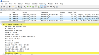

Try a packet capture from the 5 GHz radio of the AP, when doing a speed test. Please make sure to stop the capture pretty soon as the file size can go large in a short period of time, when running an internet speed test.
Login to Unleashed AP > Admin & Services > Administration > Diagnostics > Packet capture > choose 5 GHz radio button > check your AP > click "Add to capture APs" > Use local mode and filter with user device mac address > Start the capture > run speed test on device > stop with after 3 seconds of "download speed" testing.
Open this file using Wireshark. Check these captures for data packets sent from AP to your user device.  Click on one such packet > Expand "802.11 radio information" > check for data rate negotiated between AP and user device.
Should look something like this:
