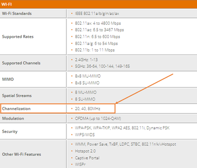

I'm trying to use Ruckus R730.
I found confusing information in different documentation:
* it's clear that it supports 20/40/80 Mhz
* in some places (for example documentation about ZC) I can see that it can support 80+80/160
To check how it works I installed vSZ v6.0.0 (the last version that has firmware for this AP, v6.1 uses old firmware)
But in the interface, if I'm trying to override parameters for 5Ghz I see only options for 20/40/80.
Also, it is connected using a 48V (at least 2A) DC adapter.
Does it actually support 80+80/160 Mhz and can I active it (even in SOLO mode)?
Thank you.
11-22-2023 08:20 AM
Hello @namezys
I found in the datasheet for the R730 this is what they support:
https://webresources.ruckuswireless.com/datasheets/r730/ds-ruckus-r730.html
This is how it looks like in the datasheet for the R650 which supports 80+80
Let me know your comments or questions.
