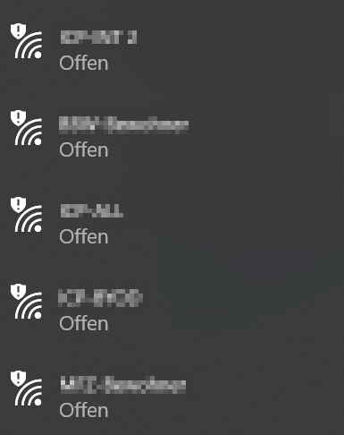

i have no problems with guest portal, after trying some things and investigating, i found out that all published Wifi Networks are shown as open after the AP Upgrade.
when doing a downgrade back to 5.1.2.0.373 the networks are switching back to secured!
