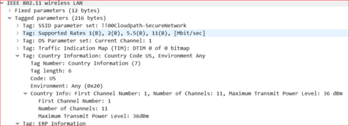

This is bit weird because we should only see 1 entry for 2.4 G radio beacon, under country information.
I just did a OTA capture on 2.4 G radio and I only see 1 entry under Country Information.
Image_ images_messages_5f91c44f135b77e247a1719e_de24b595db7b818d962a888e58111e28_RackMultipart2020022741464yrye-2b2057db-8120-477e-8156-7a58d9e6ff76-498863150.png1582823787
Could you confirm what AP model and what firmware version is running on your setup? Is the AP managed by a controller or running in standalone mode?

It looks like there is no distinction in Ruckus between the jurisdiction and the spectrum allocated and the channel plan desired by the administrator. If I set the channel plan (i.e. disable certain channels on the 2.4G spectrum) it updates this part of the beacon. It should not. The countries spectrum plan is independent of the channel plan set by the administrator. Is therefore should not alter the country jurisdiction channel information so I think this is a bug.
How specific mobile devices make use of this IE is a bit unclear too. Some devices have location assistance which can help.
You probably have all channels enabled in your configuration.
