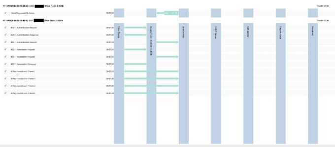

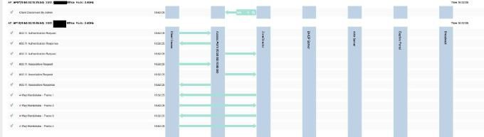

if I go into "client connectivity" then start a test, it is continually stopping at "4-way Handshake - Frame 4" then goes no further (zone director)
Every other client (apart from 2 or 3)runs past this & into the DHCP request.
But if I reboot the 1200, then it all clear up & issues a dhcp lease, but some time after that, the client trashes the DHCP again and ends up disconnected, even though the 1200 shows the mac & ip address

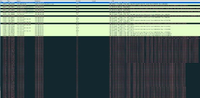

09-14-2021 06:49 PM
I did a bit more work on this, by adding a mirror port to the same subnet.
for MOST other clients
I can clearly see DHCP requests coming in from 0.0.0.0 at the exatct time you see the DHCP request on the screen for Connectivity.....
but some clients are not even pushing a DHCP request, which either indicates step 4 failed or something on the machine interfering with DHCP processing.
I can also set the time for resetting, if no DHCP lease is seen in 10 seconds,in which case it just loops, without reaching the DHCP request.
signal quality is described as "excellent"
and another station...
In the mean time i dropped the firmware down to an earlier version and earlier config.... to cover bugs & mod "bases"

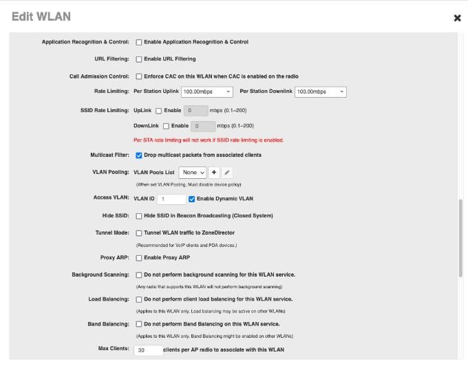

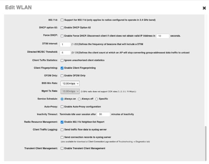

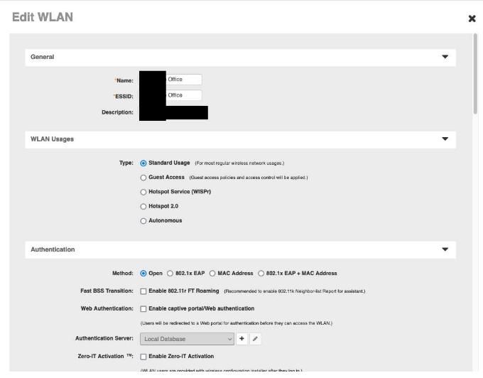

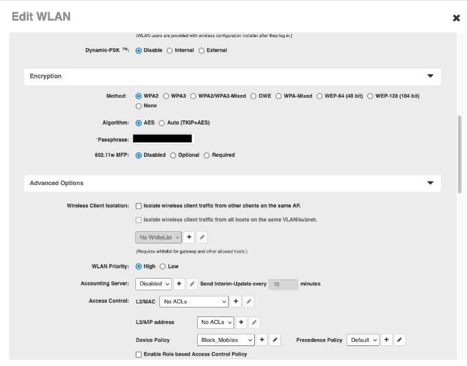

09-14-2021 06:57 PM
SSID config

Possibly something has changed on the captive gateway on the latest release?
zd1200_10.5.0.0.190.ap_10.5.0.0.190.img
I'm maybe seeing the AP continually trying to jam its crap into apple devices.
