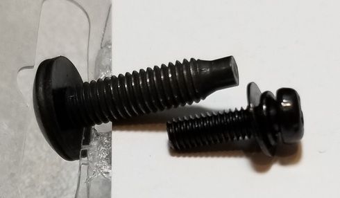

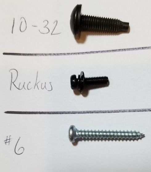

I wasn't able to find the size of those screws, but I have a spare set from a recent RMA and compared the ZD1200 screws to some known sizes.The screws that fasten rack ears to the side of the ZD1200 have the same shaft diameter as a #6 screw with threading that is tighter than 32.
A comparison of a 10-32 rack screw, the Ruckus ZD1200 rack ear fastener, and a #6 pan head:
Image_ images_messages_5f91c440135b77e2479e8da3_bedd4f840c673e1ceef9fead570439ea_RackMultipart201810161072721ca-b8095287-22c5-4554-a2fe-df53a9c37115-631137152.jpg1539699983
Comparison of the threads between a 10-32 and a ZD1200 screws:
Image_ images_messages_5f91c440135b77e2479e8da3_13c59a5cd20f3802fad164a584c7e1ac_RackMultipart2018101664418gkrb-c5b6a4e9-0bb8-470e-b9d6-c0871edb98cd-1890620918.jpg1539700002
I hope this will point you in the right direction.

Wow, thanks for the pics.  That was helpful.  I think (think being the key word) they look to be #8-32 screws.  To be safe, since the hardware store is a 40min drive from our work site, I will pick up #8-32, #6-32.  Don't know what would be tighter threading than a 32, but will definitely look.
