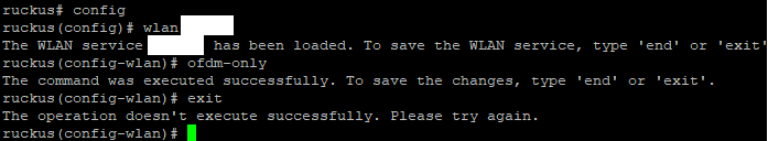

02-09-2021 08:24 PM
I finally safely upgrade to 9.1.2.0 build 8
When connecting to Zonedirector CLI I found out the config already has bss-minrate and ofdm-only mode.
The problem is when I type exit, or end, it says "The operation doesn't execute successfully. Please try again."
What of causing this?
02-10-2021 06:31 AM
I hope WLAN you are trying to edit is already configured and you are typing the correct name.
