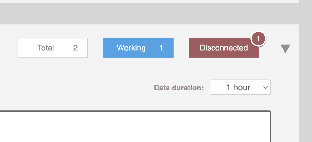

03-09-2022 01:01 PM
I have exactly the same issue on 200.12. APs just randomly disconnect and show that SSID. After a couple of minutes it disappears and everything works again, but then it repeats again and again. I downgraded to 200.11 and the issue didn't appear anymore.
I also received these notifications when it happened:
An alarm 'AP Radio Off' was triggered.
Details:
Radio [5G] of AP[ap0@58:b6:33:xx:xx:xx] is OFF
An alarm 'AP Has Joined' was triggered.
Details:
AP[ap0@58:b6:33:xx:xx:xx] joins with uptime [82970] s and last disconnected reason [Heartbeat Loss]
Details:
AP[ap0@58:b6:33:xx:xx:xx] joins with uptime [83185] s and last disconnected reason [Heartbeat Loss]
Details:
AP[ap0@58:b6:33:xx:xx:xx] joins with uptime [85591] s and last disconnected reason [Heartbeat Loss]
Details:
AP[ap0@58:b6:33:xx:xx:xx] joins with uptime [107] s and last disconnected reason [AP Restart : power cycle detect]
Details:
AP[ap0@58:b6:33:xx:xx:xx] joins with uptime [3005] s and last disconnected reason [Heartbeat Loss]
Details:
AP[ap0@58:b6:33:xx:xx:xx] joins with uptime [102] s and last disconnected reason [AP Restart : application reboot]
Details:
AP[ap0@58:b6:33:xx:xx:xx] joins with uptime [291] s and last disconnected reason [Heartbeat Loss]
Details:
AP[ap0@58:b6:33:xx:xx:xx] joins with uptime [126] s and last disconnected reason [AP Restart : power cycle detect]
Details:
AP[ap0@58:b6:33:xx:xx:xx] joins with uptime [104] s and last disconnected reason [AP Restart : application reboot]
