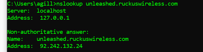

I understand the https://unleashed.ruckuswireless.com/ portal should be accessible but i cant see it, i'm using Cisco Umbrella which changes my local DNS to 127.0.0.1 as i'm using the roaming client, this gives content filtering through DNS proxy when outside of my work network. I think this may be unsupported along side Unleashed? Can someone assist.
If i nslookup unleased.ruckuswireless.com it comes back with the below address. Should this resolve to the master AP? If i try and HTTPS to the master AP I get no response, however wireless is working fine.

Ok so I just disabled my Umbrella roaming client and set DNS back to DHCP, I get a DNS server of my router 192.168.0.1.
When I do another nslookup of unleashed.ruckuswireless.com I still get the 92.242.132.24 address and it's not accessible.

If you are able to determine what IP address the Master Unleashed AP has picked up (either by looking at your DHCP clients table or perhaps running a IP scanner to look for the corresponding AP MAC) then you can https directly to that AP.
It seems that DNS resolution is a problem. the 92.242.132.24 address is a public IP and i would assume you are using private addresses internally.
