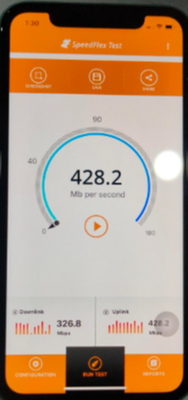

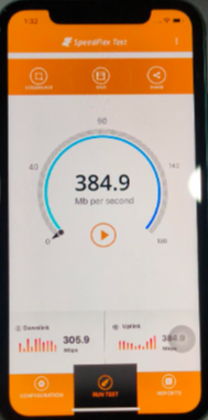

I just had a check in lab with the below setup
1. R750 and H550 on 200.14.6.1.199, with R750 being Master.
2. Used client : Android and iPhone 11 pro.
3. Downloaded Speedflex from Playstore and Apple store.
4, Clients were about 4 meters away from AP.
5. Tested client when connected to R750 and H550.
6. Tried on both 2.4 Ghz and 5 Ghz.
7. Tried both TCP and UDP test.
8. WPA2 SSID with default settings
In all the scenarios, the Uplink was never 1Mbps
Only when the client was on 2.4 Ghz, the speed was showing Uplink 3.5 Mbps and Downlink 43 Mbps.. Probably because of the lab environment with lots of interference.
Below are the results:
2.4 Ghz:
5 Ghz:
iPhone
Android:
