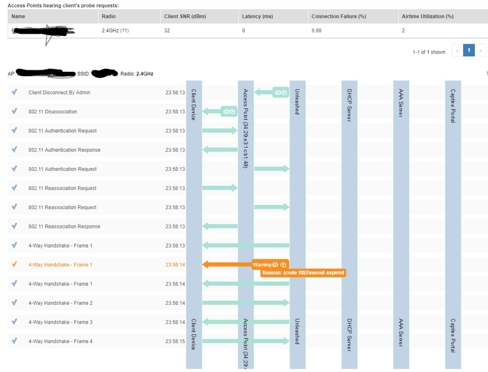

I figured out that I have the same issue (client is displayed as connected but unreachable after ap reboot) with my printer. It is easier to solve this problem first and then have a look at the multicast-issue with the sonos. I also figured out how to capture in the air with my WlanPi and Wireshark.
Which information could I share with you so you could have a look at? In the attachment you can see the output from Troubleshooting. The troubleshooting itself does not repair the connection

Hi Beni,
Unleashed troubleshooting utility will help you to find at what point client is failing but it can't fix it.
You have to check the OTA packet captures and look for more details in 4-way handshake message-1.
Try to connect this device to an open SSID and check if it connects or not.
If this is a general issue, all the devices should face this issue, but I think only specific device has the problem in your case.
