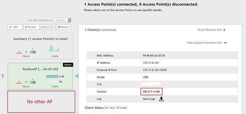

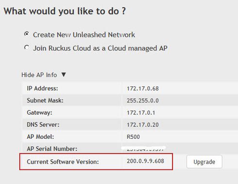

Factory Default did not solve my problem.
Image_ images_messages_5f91c427135b77e24798d398_cd3260ef4fb0489e67a263f4c5c04bf1_RackMultipart201510093523cfclc-02dd13bb-b438-4426-a7b6-29ec74e1c004-1324644693.jpg1444380665
Firmware Version from my first initial AP: 200.0.9.9.608
From my inital Unleasehd AP i don't see a second AP.
Firmware Version from the second AP: 200.0.9.9.608
