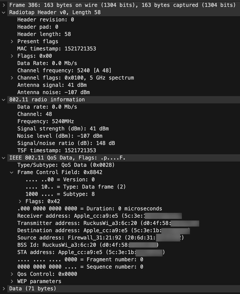

I pulled a Wireshark capture from my iPhone 14 Pro that was 10ft away, clear line of sight, to the R650:
Am I good to go, or is more investigation needed?

It seems the iPhone14 is getting 60-70% of the speed you are getting from wired Mac 936/938 Mbps, so it looks good to me. Since the AP need to serve the other clients associated to it, the 1 Gig speed will be distributed as the medium is shared for other clients based on the traffic or client priority in the network.
To evaluate the wireless throughput,  I would recommend iPerf for the better results. Please check the below article and let us know if you have any other queries.
