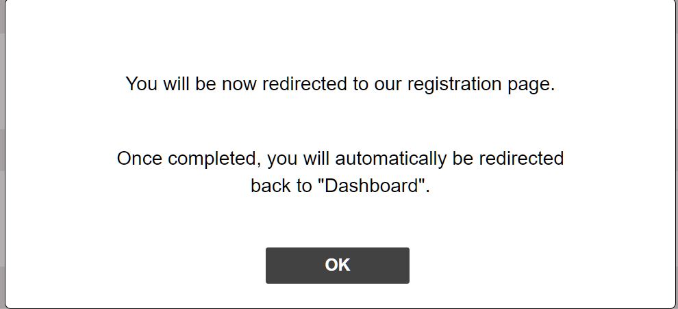

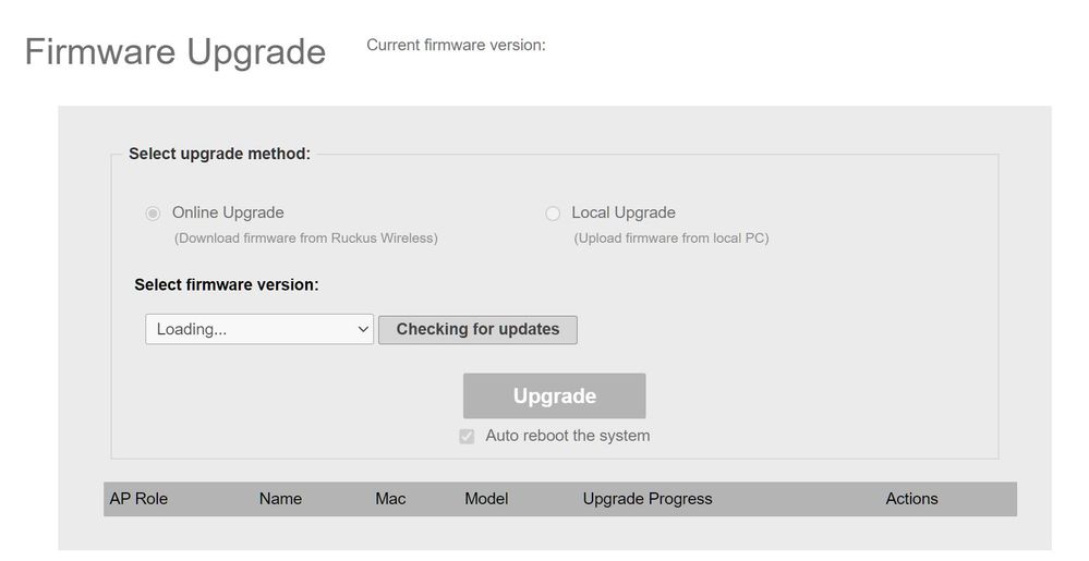

I have a group of 4 R510's they've been working great for about 4 years. About a year ago I did an upgrade. For the past week they've been having performance issues so I thought I'd start from scratch. I asked them to reset them with the paperclip. I wanted to go straight to the upgrade but that area is greyed out. I did notice that when it came on it mentioned registering them.
It says ruckus "you will be now redirected to our registration page" with a continue - nothing happens when I hit continue. I've disabled the pop up blocker for the APs addresses - still no luck. Tried in Chrome and Edge (no I don't have anything with IE any more). Is there a website I can manually type in or can I force the firmware?
You can click the OK but other than days turning to nights, nothing happens - tried several browsers, different computers.

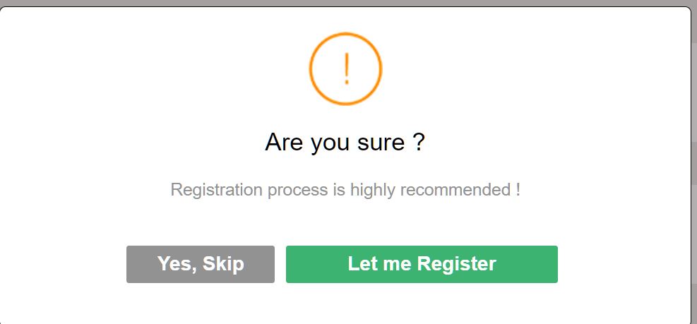

You can try skip - and you'll get
Let me register doesn't let you register.
If you do clip skip and go to this you can't click on anything

Hi @bdillard
You can try doing the upgrade from CLI as well, but the easiest way would be to use Unleashed application.
1. Install the Unleashed application.
2. Connect to the SSID and open the application.
3. Through the application, upgrade the APs.
