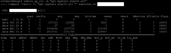

I checked whether the packets in the queue are properly classified using the command below.
remote_ap_cli -A "get mqstats wlan32 all"

I'm having a problem in practice, which is that when I use IDM (internet download manager) to open multiple TCP connections on Google Drive to download files, there is no margin on my bandwidth.
The actual IDM download speed exceeds 50MB/s, and in this state, other tasks (web browsing, video stream, etc.) cannot obtain the required bandwidth quickly.
I sometimes do more than 10 simultaneous downloads, which seems to exceed the AP's packet-per-second capability.
I am using openwrt on my intel celeron J4105 mini pc and I solved this bufferbloat issue of wired connection by setting sqm(cake).
However, sqm only works up to about 300Mbps for Wi-Fi connections, and beyond that (my speed) is ineffective.
This is probably because there is a separate buffer in the wireless mac-layer.
So I surfed the web for a while to solve this problem and found out that I can use WMM QoS through DSCP marking.
WMM QoS completely solved my problem and google drive downloads went to the background queue and became the last priority.
You can see the BK queue and this is the value created by google drive download.
