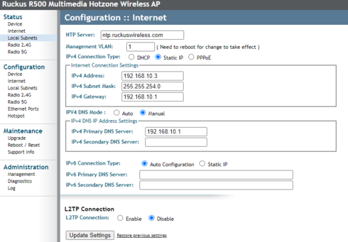

I've bought an older R500 AP and flashed the last released standalone image on it. The AP is connected to an stupid layer2 switch and this one is connected to a physical OPNsense port. On the OPNsense the gateway for the LAN is 192.168.10.1/23 and the AP has the 192.168.10.3 in this case.
After creating the local subnet and the DHCP configuration, the connected client can't reach more than the gateway on the OPNsense, but the Ruckus AP with 192.168.10.3 can reach anything in the WWW without any problems. I also checked the incoming traffic to the FW and you can only see the connection to the gateway from the client but e.g. pinging the google DNS gives me now connection logs on the FW, so it seems, there is no incoming traffic passing it.

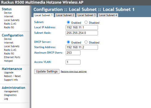

Attached you can find the configuration settings as screenshots.
I have no DHCP server running on the firewall gateway, the AP is doing the DHCP job. This works fine, I get an IP and everything with that. But there is no connection after the gateway.

I can see that you have configured local DHCP server in the same subnet as AP IP address.
AP IP 192.168.10.3/23 and DHCP IP 192.168.11.1/23 both belongs to same network ID 192.168.10.0/23.
Usable IP host range in this subnet is 192.168.10.1 - 192.168.11.254.
Try to configure a different subnet for local DHCP subnet like 192.168.10.1/24 (255.255.255.0) and check if this fixes the issue.

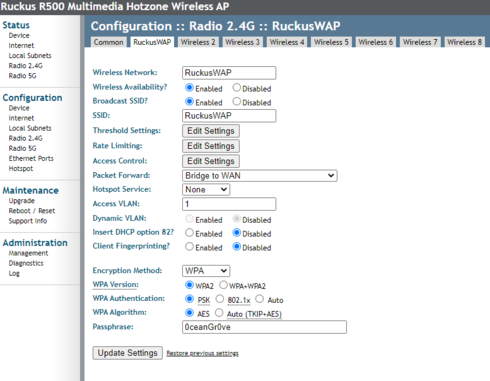

In the attachment there is the configuration of the Wifi.
Do I've to configure some ACLs for the traffic?
