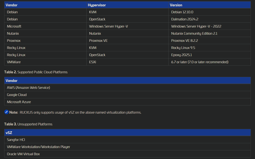

Hi lsmith,
Please find Supported Hypervisors and Support/Engineering would not be able to assist on other platforms which are not tested or approved.
-HTH

The platform is Red Hat OpenShift, which I see if not listed above - this most likely the root of the issue.
