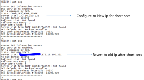

I have attached results at failure of migration.
#define AP FW version (must match the AP version in the zone)
fw_version=5.0.0.0.753
#define Model class (only option available is 'all')
model=all
# Command (these are examples, any AP CLI command will be accepted; One command per line)
set scg ip 172.16.100.222 -----------> It's new sz ip.
reboot
< execution result of ap script
Image_ images_messages_5f91c44a135b77e247a0794f_10d451728a788a9537bdb279efa585b2_RackMultipart201903061262021qj-766fbb3f-191a-4fc6-9a68-7d5d4e394a3c-1029130919.png1551860485
< symptom : revert to old ip after applying script or cli to change ip ro new sz ip.
Image_ images_messages_5f91c44a135b77e247a0794f_760a49231d73de55ad7989ad3b568370_RackMultipart20190306109479oc0-d3347ec0-7fa8-40b3-86fe-b55d36542328-1007894688.png1551860589

But from our a test,  when aps don't reach new ip of sz due to some reason such as network issue, acl issue, joining at staging zone of vsz-H, and so on, Ap revert to old IP of sz.
Sometimes this problem can give us the inconvenience of migration.
Such as when we change only ip address in a sz, when new ip is not ready yet and so on.
We hope to improve it.
