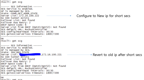

I have attached results at failure of migration.

set scg ip 172.16.100.222 -----------> It's new sz ip.
reboot
< execution result of ap script
Image_ images_messages_5f91c44a135b77e247a0794f_10d451728a788a9537bdb279efa585b2_RackMultipart201903061262021qj-766fbb3f-191a-4fc6-9a68-7d5d4e394a3c-1029130919.png1551860485
< symptom : revert to old ip after applying script or cli to change ip ro new sz ip.

The commands - set scg ip as well as DHCP option 43 or DNS are only used for initial SZ discovery for factory defaulted AP's.
Once an AP has been controlled by an SZ the controller IP list (c-list) is stored internally in the AP and the discovery process will not work.
To make the AP "forget" the previous controller IP you need to run the following command:
set scg init
This command will clear the internal c-list, reboot the AP  and put the AP back into discovery.
You can then use the set scg ip to move the AP to a new IP or cluster.
You could simply add the set scg init into your AP CLI script.  I have tested this and the set scg ip command does get executed before the AP reboots.  But to be certain you could do two AP CLI scripts - first one to do set scg init, second set scg ip
Note - if a DHCP option 43 or DNS entry exists that moves the AP back to the old IP or cluster then the AP can be sent back to the old IP.  Best way is to remove or change these settings, but I have also been able to force the AP to the new IP by running the two commands together before the AP reboots.

It works properly.
But from our a test,  when aps don't reach new ip of sz due to some reason such as network issue, acl issue, joining at staging zone of vsz-H, and so on, Ap revert to old IP of sz.
Sometimes this problem can give us the inconvenience of migration.
Such as when we change only ip address in a sz, when new ip is not ready yet and so on.
We hope to improve it.
Regards.
In addition, I found if someone have option 43 for new ip, they can just apply cli as  " set scg init ".
After applying the command and rebooting him, AP start to join to new ip recieved from option 43.
Regards.
