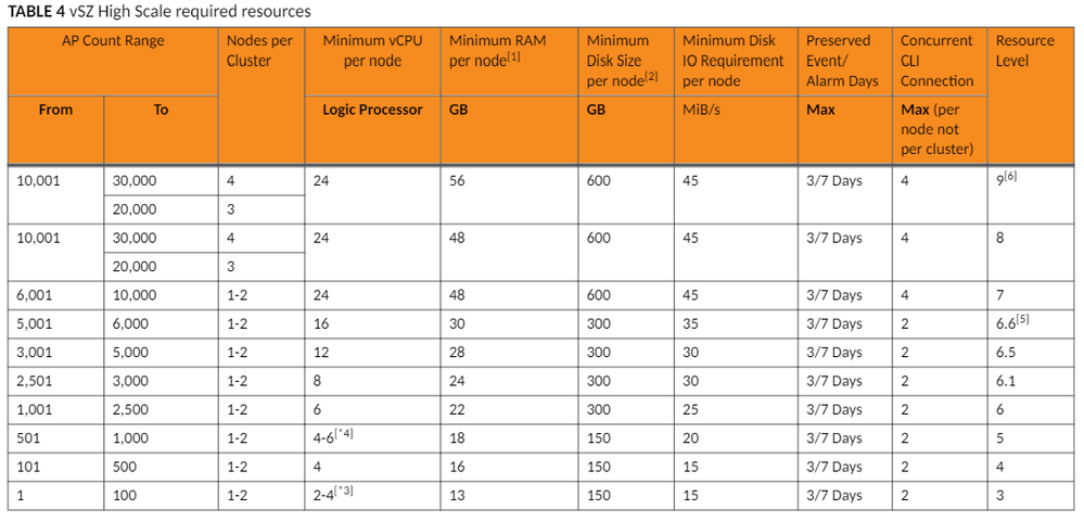

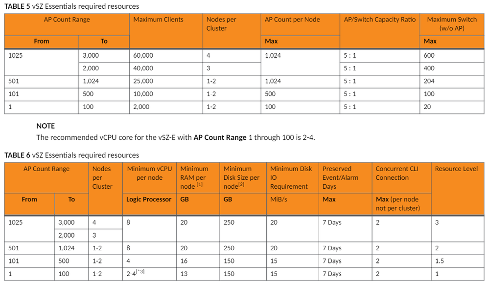

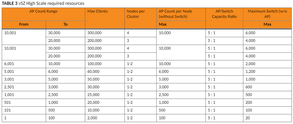

Hi @tomoya
The vCPU, RAM, and Disk Size values are interconnected and must meet the minimum requirements within each resource level. When adjusting any of these parameters, all three values must be equal to or greater than the requirements of an existing resource Level. So you can allocate more CPU but the other parameters should meet the minimum numbers in the table.
Below is the minimum requirement for vSZ-H and vSZ-E for 6.1.2 release.
I understand that vCPU and RAM and Disk need to meet the minimum requirements.
What I want to know is to what extent it is possible to increase the vCPU allocation as an OS.
I would like to know whether it is possible to add an unlimited number of CPUs, ignoring physical limitations or host OS limitations, or whether there is an upper limit set due to OS limitations.
sanjay_kumar
RUCKUS Team Member
Hi @tomoya
You can add the max CPU, which will improve the performance, but there is no upper limit on the vSZ.
But numbers on the table provided should be more than enough to maintain the devices and provide better performance.
