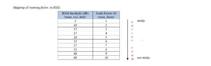

Could you just include some additional info regarding the scale factor?
In my vSZ-H the clients' RSSI levels are expressed in dBm. Currently the worst client signal stands at -71 dBm, and I'd rather have it disconnected as I'm sure the endpoint can get a much better signal from a different AP.
I just don't understand how to read the RSSI dB column in the pic above.
