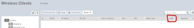

We use Dynamic VLANS very frequently with our RUCKUS builds and it's rather helpful to sort by VLANs when troubleshooting client issues. I think the only way it could be better is if we could also search for devices on a specific VLAN in the clients section of the VSZ. Is this something that could happen in the future?

Let me clarify. I already know you can SORT by VLAN but I would like to be able to SEARCH by typing in a VLAN number in the search field and only pull results associated with that VLAN.

If you type something in the Search Table box, such as the VLAN #, if it is in the table below it should highlight it providing what you need.
I have only tried this typically using a MAC or IP address, or hostname, but I believe the search is for all fields. Actuallly just tested and it does work -- although the number does need to be unique. e.g. if using VLAN "1" and you enter the number 1 in the search you will see lots of things highlighted like numbers in the MAC or IP or even Channel.
But if you use uncommon VLAN IDs such as anything 1000+ it should not result in multiple matches.

We don't use uncommon VLANs though so that does not fully meet what I'm asking for.
