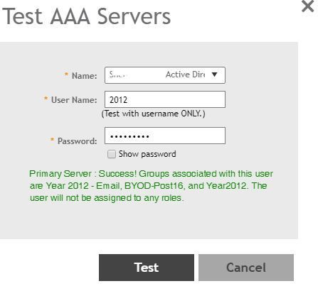

It would seem that Ruckus have finally brough in the Active Directory Group lookup as shown here from my vSZ-H setup:
however they haven't yet implimented the ROLES side so this user who is a test user in our AD is in the correct AD Group, however they aren't limited to join a specific SSID.

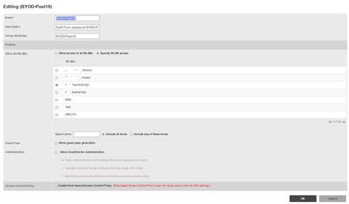

Here is what i am using now in the ZD1200 and would have hoped to have seen the same in the vSZ but this isn't the case:
What the above 2 images from my ZD1200 are showing is, picture 1 is showing the ZD querying our AD to find what group memberships user 2012 is part of.
Picture 2 is showing the options under ROLES so that if the GROUP ATTRIBUTES field matches those that the user is part of in AD, the user is able to access that SSID.
This feature is missing from the vSZ and cannot be found!
