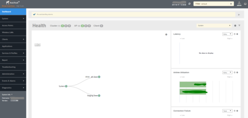

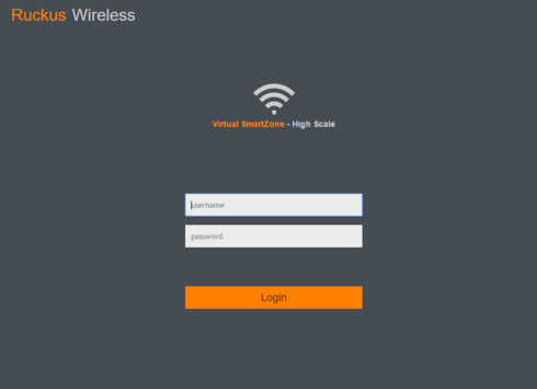

I've asked my reseller to look into the AD problem too but they came back with creating a rule and force them on to a specific VLAN, this is not what i want to do, i'm wanting to stop a specific group in AD from being able to connect to a SSID.
Here are 2 screenshots of 3.5 - the login screen and the home page which can be customised.
Image_ images_messages_5f91c431135b77e2479aee49_b15902f8acafef566d1d11dfa486fbf0_RackMultipart2017041945263p6yu-c79f5135-dc89-469e-9fbc-8582700ca9f2-1514718001.PNG1492601542
Image_ images_messages_5f91c431135b77e2479aee49_1dcbf5f12234b129a1d7c6ff1d301899_RackMultipart201704196661310a0-9de9c83a-3f52-4e5e-80d8-55d38746d5fa-1014696559.PNG1492601552
