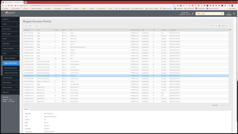

The same SSID on the same APs in the same vSZ zone is periodically declared malicious by different AP.
yuriy_babak
Hey.
We use vSZ-E (3.5.1.0.296) with 80 access points.
6 zones are configured of which 2 without access points (used as a template).
In one of the zones there are only 6 access points.
But a strange thing happens in her ...
"An SSID-spoofing rogue AP [24: 79: 2A: 2B: 55: BC] with SSID [TavriaV_Intercom] is detected by [AP-R510_Ark_47 @ 24: 79: 2A: 2B: 55: B0] on channel [153]."
Those. the access point has declared its own BSSID malicious!
In the remaining zones, everything is OK.
I made a stable zone clone, corrected VLANs, moved these 6 points - I got the same problem.
When scanning WiFi, you can really see duplicate SSIDs, sometimes with different authentication settings (some key suddenly appears on an open network).

yuriy_babak
Image_ images_messages_5f91c44c135b77e247a0ce2d_82e1abda2f384f4a91039edb5876693a_RackMultipart2020022035123do3s-944b7709-f109-449a-b302-85987d013069-1626998337.png1582237753
Some picture about this trouble.

hyosang_choi
Valued Contributor
There may be WIPS around using the TARPIT method.
