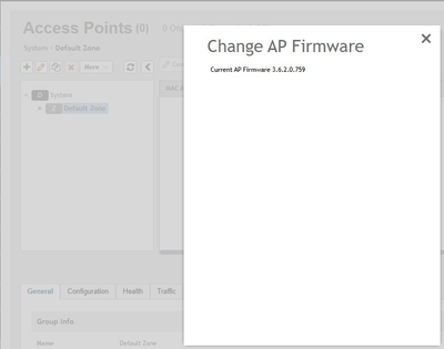

Hi everyone,
I recently purchased a SmartZone 104 appliance and encountered an error when upgrading it from 3.6.2 to 5.2.x. The error is identical to the one described in this forum post: "your current system cannot be upgraded. Reason:The system cannot be upgraded, because the following zone(s) will be unsupported: v3.5.1.0.419 * 1"
I attempted to fix the issue by following the instructions in the post, which involved changing the AP firmware. However, the default zone remains stuck at 3.5.1.0.419 and cannot be upgraded. Consequently, my SmartZone is stuck at version 3.6.2, and I am unable to proceed. Additionally, I have not yet connected any APs to this zone.
I also tried adding H320 APs, but they failed to function, possibly due to a firmware mismatch between the WLC and APs.
I would appreciate any assistance in resolving this issue and upgrading my SmartZone to version 5.2.x.
