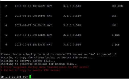

Hi, I recently changed the PC that hosts filezilla server for all cluster backups. Before I have never had an issue with filezilla and backing up from the controller CLI.

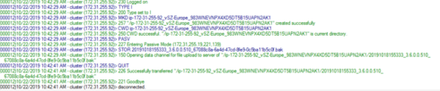

Since I am using this new PC the backup starts, then always fails when the file transfer reaches about 90%. In filezilla it says successful, but on the controller it says an error with transferring the file.
Ruckus support have confirmed the file i export cannot be used.

I have in the controller GUI configured the FTP server which works. My configs are backup to this automatically and as far as I know this works fine.
However full cluster backup export from CLI has the error in the screen shot of the CLI. And also screenshot of what filezilla is saying.
