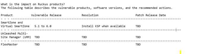

What is the impact on Ruckus products?
The following products are not vulnerable: All Access Points, ZoneDirector, Unleashed, ICX Switches, SPoT/vSPoT, and RUCKUS Cloud.
The following products are under assessment: Cloudpath, IoT, MobileApps, RUCKUS Analytics, and SCI.
The following table describes the vulnerable products, software versions, and the recommended actions.

Thanks for the text. Download is working now. Is there an ETA on the patch?
