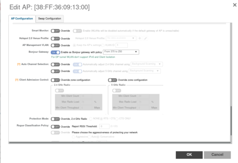

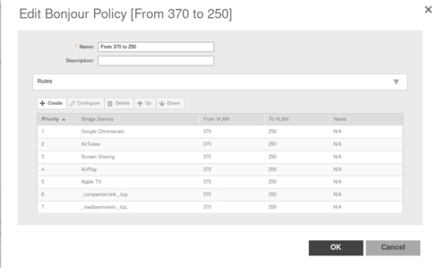

I have two different vlans - 250 (for users) and 370 (for AppleTV). I configured my SZ100 according to the manual, but the service does not work - I see AppleTV on my Iphone, but when I try to connect, I get an error about the device unavailable.
Image_ images_messages_5f91c401135b77e247915856_00cdf1a6a5a06186fc6c38c7bcaadc9d_RackMultipart20200904298711aml-339c3ebd-5495-43c5-a6b6-ae66bd87528b-1599783968.png1599218237
Image_ images_messages_5f91c401135b77e247915856_923e703c85c984d4ac6fc5cbb3b7a6ed_RackMultipart20200904340031wcc-b820f54f-cd85-4960-b3f3-25513532ec7e-1625808388.png1599218176
There are Cisco and HP switches between the devices with igmp-snooping disabled. AppleTV have a wired connection to switch. Have any ideas why it does not work?

I also see that you have only configured rule from VLAN 370 to 250 but not the vice-versa. Any specific reason for this?
I suggest creating bi-directional rules for all the services and VLANs.

The problem really was connected with IP connectivity between devices.
