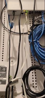

we had a power outage. The internet is working fine but their is no power to the access point. on the board itself has a green and amber light. Please advise.

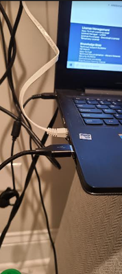

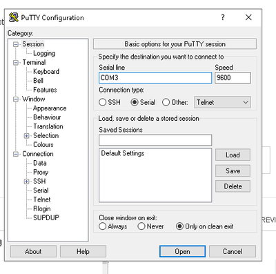

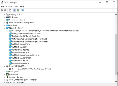

Please let us know whether you have performed software recovery process or not.
Also please share the screenshot of the error you are getting while following the steps.
Shar_0-1688589611152.pngShar_1-1688589738602.pngShar_2-1688589923745.pngShar_3-1688589951793.png
I also tried setting ipaddr to 192.168.0.2 - same result

For detailed understanding of the issue please share the LED status of the switch and the access points using the below guide.
