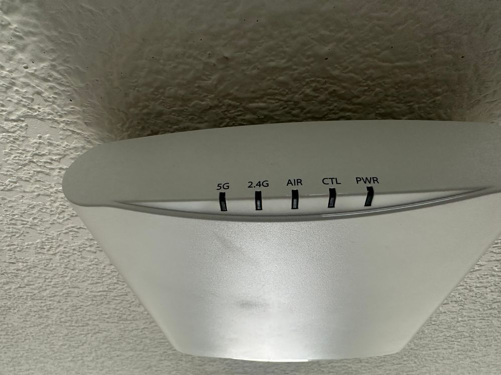

We changed service provider from xfinity to AT&T and after that our Ruckus is working but Ruckus AP 510 (on first and second floor) is just not getting powered on.
Please help to resolve as noone in this world is able to help.

Attaching 510 snapshot for more details :

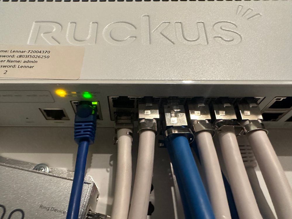

1. On your switch while it's plugged into the outlet, do you see any lights on? (Amber or green) Please let us know which lights are on. (Please refer to the below picture and share a picture of the same, showing the light status and the cable connections to the Switch ports)
2. May I know how many Access Points are connected to the Switch?

Hi @jignesh43
Thank you for the information you shared,
As we can see from the picture you shared, there is an amber/orange light on the "SYST" and a green light on the "PWR" on the Switch. Meaning the Switch is stuck in the boot mode.
Basically, due to the power outage/power spike, the switch went to a state that we call ‘boot mode’ that is not able to boot up properly.
Please remove all the ethernet cables from the Switch panel and try to reset as described below.
First, we will try to reset the Switch as described below:
IF RESET IS NOT WORKING, PLEASE TRY TO RESET YOUR SWITCH MULTIPLE TIMES (At least 10-15 times) AS DESCRIBED ABOVE.
