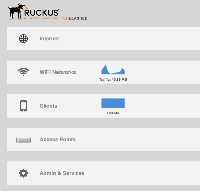

I had to completely reset my switch and APs due to adding another AP with an older firmware. I had to recreate the unleashed network. It now shows all three APs but the switch does not show up on unleashed (see screenshot). Does this matter? If so, how do I fix it?
Thanks

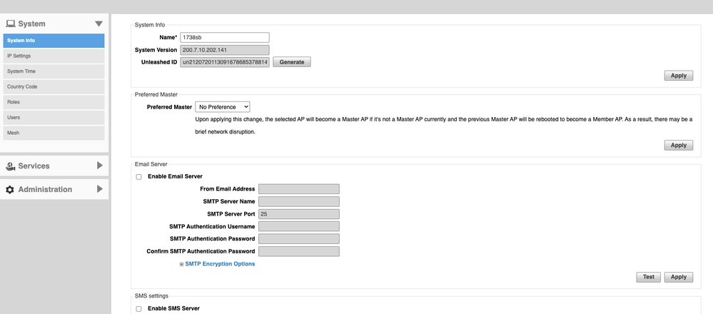

Make sure the management approval is enabled.
If it is already enabled or once, you enable it please hard reboot your Switch (disconnect and connect the switch from the power outlet). Once the Switch boots up, please try to refresh Unleashed and check the Switch status.
06-19-2023 11:05 AM
The 'switch approval' box does not show up on my unleashed. see pic:
