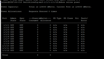

Here is the output after running those commands
06-05-2023 09:40 AM
After hard reset:

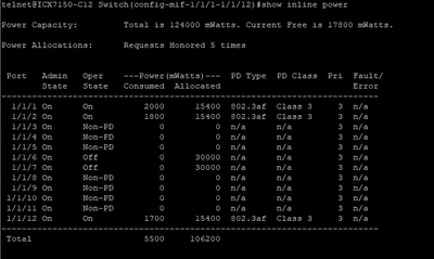

After enabling inline power

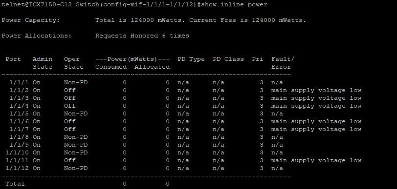

after a while it will stop with the error of low voltage

Hi @andrew
As I can see from the Screenshot you shared, your Switch is currently on an old version and that is 8060 as marked in the below screenshot (non-UFI). To avoid this issue I would recommend you Upgrade your Switch to the latest stable UFI version.
The recommended stable versions are 8095g (08.0.95g) or 8095j (08.0.95j)
The Upgrade path would be 8060>>8080f>>8095g OR 8095j
Below are the options or methods to perform the Upgrade on the switch: You could choose any one of these.

As you can access CLI, I would suggest you follow the 2nd option.
