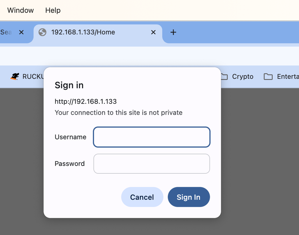

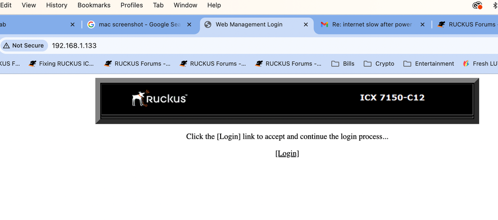

The below screenshot is far as i get. Unfortunately the passwords don't work. I know my password for my unleashed dashboard. Should it be the same? However that does not work for the switch either. Is there a way to access the switch without a username and password? I want to see if this is truly a routing issue.
Thank you!

Hi @ANgu0524
Could you please download the PuTTY application and attempt to log in to the CLI using the Switch IP Address identified in the IP scan? You can download PuTTY from the following link:
🔗 https://www.putty.org/
Connection Method:
Telnet – Port 23 (if SSH does not work)
Once connected, the command-line prompt should look similar to one of the following:
ICX7150-C12 Router>   OR   ICX7150-C12 Switch>
Please enter the following commands after logging into the CLI (press Enter after each command), and share the output:
show version
show flash
You may either copy and paste the command output or share screenshots. If you encounter any issues or errors, feel free to share those as well. I'm here to assist you with any questions you may have.
