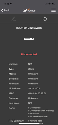

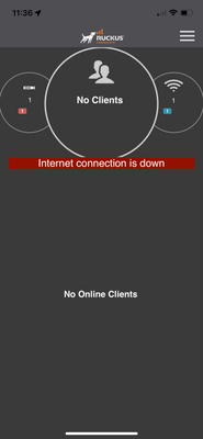

Hi I reset the AP and here is what I’m seeing in the app.
Hi @Alex1
Hope you are doing well!!!
Please try to reboot your Switch and check the Unleashed dashboard. Sometimes the Switch may require a hard reboot (disconnect and connect the switch from the power outlet). Also, Unplug and plug the ethernet cables from the Switch ports panel and plug them back again.
