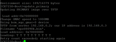

As per the case description, I could understand that you are trying a software recovery of the Switch which is stuck in boot mode. And getting a ‘kernel image’ error and the ping is not alive.
As "host 192.168.0.3 is not alive"
Are you turning off the Windows firewall? If not, please turn off the Windows firewall and retry the software recovery process once again.
Please refer to the below link on how to turn off the Windows firewall:
https://support.microsoft.com/en-us/windows/turn-microsoft-defender-firewall-on-or-off-ec0844f7-aebd...
Please let me know if you are getting the same error or are stuck at any point in the software recovery process.
