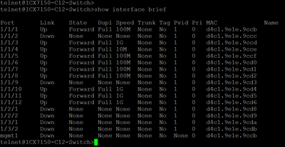

Hi, I have 3 APs connected to CX7150. These were installed by Lennar in 2018. I now have issues with the APs dropping connection frequently. I have to restart the CX7150 to get back online. But even after restart, these provide very erratic connection with speed ranging from 17 to about 190 MBPS while my wired connection provides over 950MBPS at any point of time. I do not have my unleashed account details (forgot).

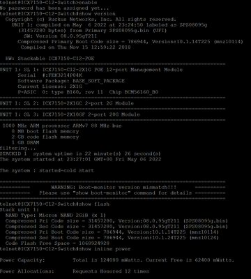

I followed your instructions to copy the secondary flash. After reboot, I see only one AP has come up and the other Two APs have flashing Power LEDs. Here are the other details:

I did that. But the issue remains the same. The unit works for a little while after restarting and then the internet drops on all the Apps. I tried moving the connections to different ports. And unplugging and plugging back the switch power. The issue repeats.

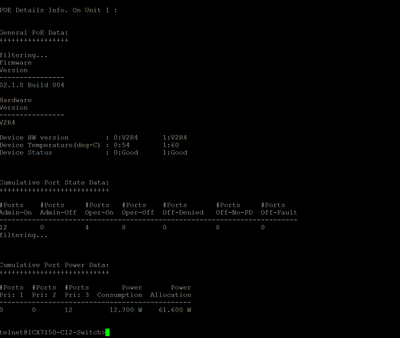

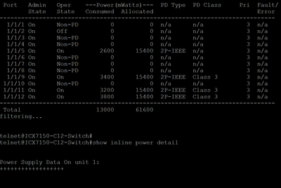

Thank you for sharing the requested information.
Based on the troubleshooting performed, your ICX-7150-C12P Switch PoE ports are not responding properly, and the troubleshooting did not help. A reset was also attempted; however, the issue still persists. This indicated a Hardware issue.
As a result, this Switch unit appears to be defective and needs to be replaced through the RMA (Return Merchandise Authorization) process.
