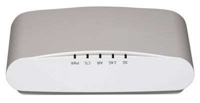

 2-Are the Access Points powering up , please let me know the color lights ( any fleshing light or red ) ?

The lights on the APs are green with one being yellow. The cables are connected properly. And I went through the step by step instructions for routing fix within Putty and the process completed.
Hi @Finnejo
Hope you are doing well!
Basically, the yellow light means that there are not clients connected on that specific Radio (5G or 2.4G) that depends where is the yellow light on.
Note: Can be green light on 5G and yellow light on 2.4 that means that there is a device connected on 5G radio and not on 2.4 Radio
This does not mean that the Access Point is broken or damaged.
Here is the meaning of each light on the Wireless Access Point
https://docs.commscope.com/bundle/unleashed-200.9-onlinehelp/page/GUID-19D4261B-D10B-4DE3-B63A-3498F...
Yellows light 2.4G: Radio is up, no clients are connected to the 2.4 GHz radio.
Yellows light 5G: Radio is up, no clients are connected to the 5 GHz radio.
So, if there is a device (iPhone) that is using the 5G radio, the light on the Access Point will be turning green on the 5G radio indicating that there is a client/device using that radio (5G)
