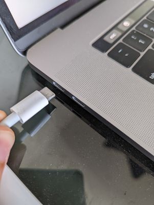

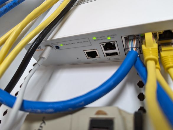

Last night both WAPs turned on with green lights BUT any device connecting to the Wifi cannot load anything (websites/apps timeout). I can select it as an option in the wifi list (with full signal), but it isn't usable. As you can see in this photo of the switch, STAT, SYST, and PWR are green.
Does this mean there is a different problem?

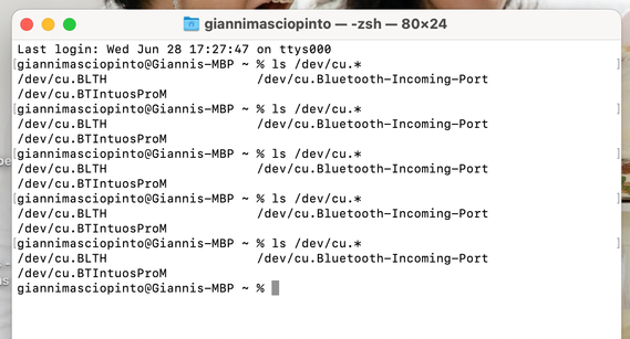

1. I installed the drivers.
2. I opened Terminal and ran the command "ls /dev/cu.*" and noted the list of 3 results.
3. I connected my Macbook to the switch via type-c USB (as shown below and the photo above), and ran the command again, but the same 3 results show.
Please advise, thank you for your help.
