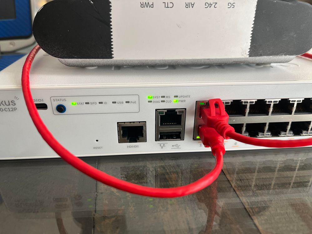

2. On your switch while it's plugged into the outlet, do you see any lights on? (Amber or green) Please let us know which lights are on. (Please refer to the below picture and share a picture of the same, showing the light status and the FULL Switch panel cable connections to the Switch ports)

4. May I know how many Access Points are connected to the Switch? Could you please let me know the light status on the Access Points? Any of these lights are on (Please refer to the below picture and share a picture of the same)
The light on the switch are all green. In the status box the STAT light is green. Outside of the ststus box the SYST and PWR lights are Green. Ports 1 & 2 have green link lights.
The lights on the AP are green for the PWR and CTL. PWR is solid and CTL are flashing.

As per the picture you shared, the Switch seems in a normal state.
