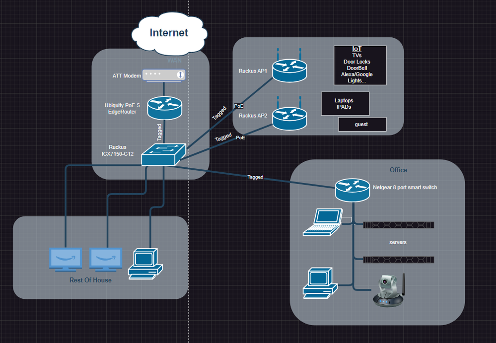

(2) Ruckus AP managing through Ruckus Unleased. Only 1 SSID shared by both. Like to create a Guest/IoT/Home vlan SSID.
Goals
Create the following VLANS
Here is my rough out of physical network devices after I'm done. Today , it is just the ATT box direct to Ruckus/APs
I was able to get to the switch console, and watched a few videos on how to create VLANS. Not sure if this switch is capable of it, but seems layer 2 only features? My Router will setup all the routes in/out of VLANS?
