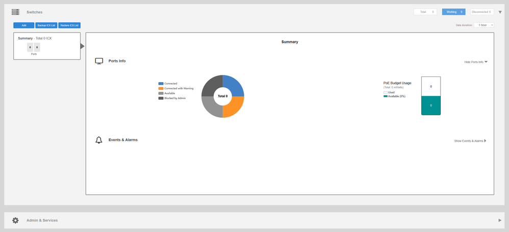

As the title says, my home network is visible within the unleashed mobile app. I can see both of the APs and all the details associated with them. When you cycle through the "carousel" of options at the top "no switches" are visible on the switches section. Shouldn't I be able to see and manage my switch from there?

Hello @adamb303 ,
I understand that your Switch is on older version, which is 08070c.
We suggest upgrading your switch to the latest stable version to avoid this issue in the future.
Please follow the below RUCKUS Lennar Knowledge base self-help article which will help you to upgrade the switch to the recommended version.
Please follow the process explained in the article and let me know if you have any queries in this regard.

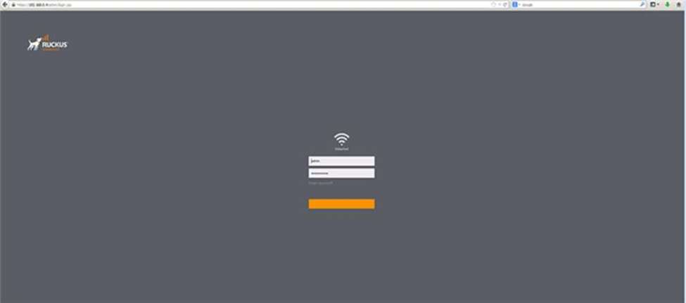

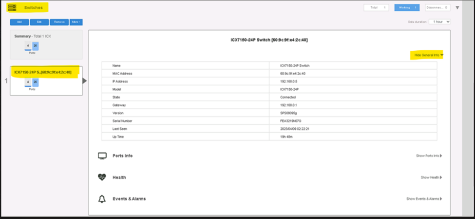

Hello @adamb303 ,
From the case description, I understand that you are unable to access your RUCKUS Switch through your Unleashed app.
I would request you to please login to your Unleashed system on a web browser using the Master AP IP Address or https://unleashed.ruckuswireless.com/ and share the screenshot after pressing the Switch option.
You should see the below-Unleashed dashboard after finding the IP Address of the AP. Try to log in
Could you please log into the unleashed system and share the screen shot showing the below details?
Please share the requested information and let us know if you have any queries in this regard.
