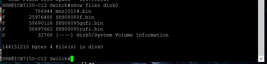

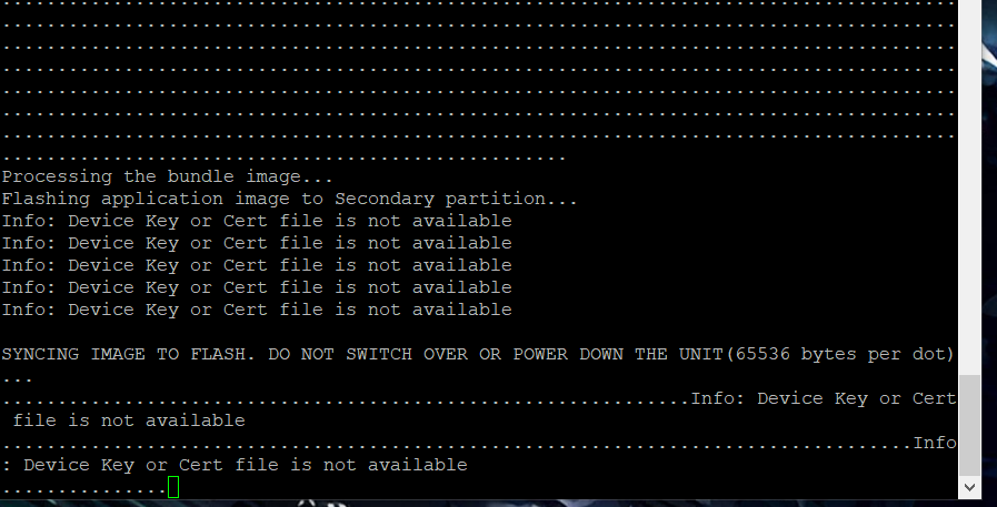

Capture.PNGCapture3.PNGCapture4.PNGCapture5.PNGUnable to Update to 8095r get Info: Device Key or Cert file is not available when going through copy disk0 flash

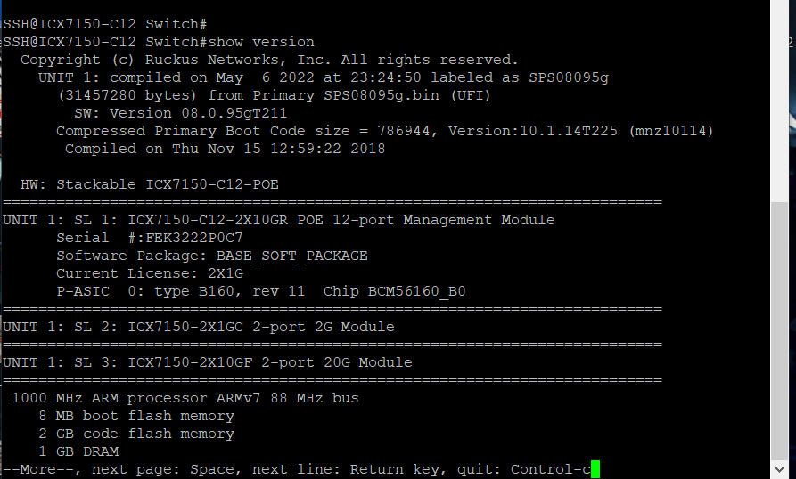

Currently at  Version:08.0.95gT211 (SPS08095g.bin)

Hi @Khizza83
Thank you for your response.
Yes, you can upgrade the secondary partition to 08.0.95r using the SSH option. Later, if needed, you can revert it back to 08.0.95g by copying the image from the primary partition using the command - 'copy flash flash secondary'
If you have any questions or need assistance with the process, please feel free to reach out.

However, if you would like to proceed with the 08.0.95r version, please share the output of the following commands:
show version
show flash
dm verify-device-certs
