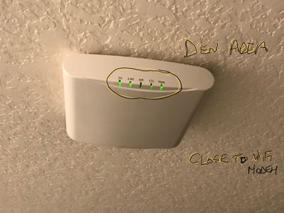

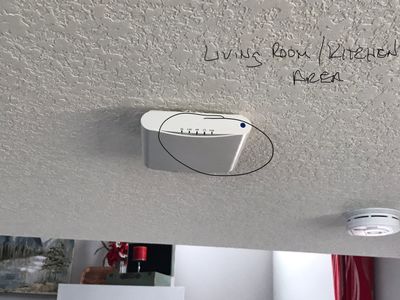

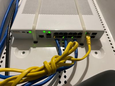

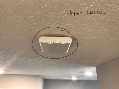

The yellow cable identifies the connection from the spectrum router to the switch. The blue cables identify each connection from the router to the access points.

As per the light status of the RUCKUS ICX-7150-C12P Switch and the R510 Access Points, they seem to be in a normal status.
As I see from the picture you shared, seems like the ethernet cable (Yellow color) which is coming from the ISP’s (Internet Service Provider’s) Router or Modem/Router combo is plugged into the wrong port on the Switch panel. It must be plugged into any 1 in-12 ports as shown in the below screenshot. Please unplug the ethernet cable and plug it into the correct port and reboot (Unplug and plug from the power outlet). After this process check the Internet connectivity.
